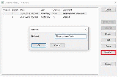

- Create a new branch of the network. Right-click the network in the model group window and select
Show commit history. Select the latest committed version in the list and click
Branch on the right. Name the new network appropriately and click
OK. Close the Commit history dialogue.

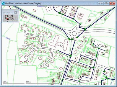

- Display the
background map, that is make roads, building and general features visible on the GIS Layer Control dialog:
- Click the
(Go to XY Coordinates) button. Type in 452289 for X and 159183 for Y.
- If required, click once or twice on the Zoom in button of the dialog to get the desired zoom level.
- Click OK. This takes you close to the new estate which is shown on the map but currently there are no nodes or links serving it.
- Right-click the GeoPlan and select Layer control.
- Click the Visible box for the Roads, Building and General layers.
- Click OK. If there are no background layers, you will need to add these layers. (The layers are in the tutorial data.)

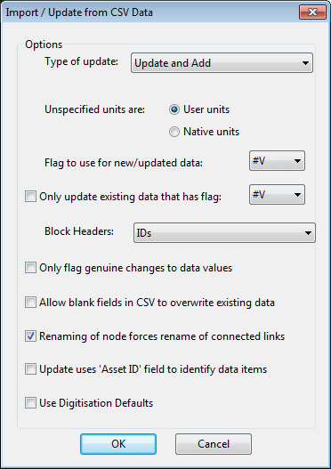

- Select
Network | Update | From CSV files. The import dialog is displayed.
- The defaults are acceptable, so click OK. You are asked to select a CSV file to import.

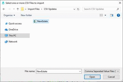

- From the
Example Data Directory, select Tutorial Files/Import Files/CSV Updates/NewEstate.csv and click
Open.

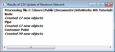

A window is displayed, detailing the number of objects (nodes, pipes and customer points) that have been created. The screenshot below shows an example of results of CSV update window.
Close this dialog.

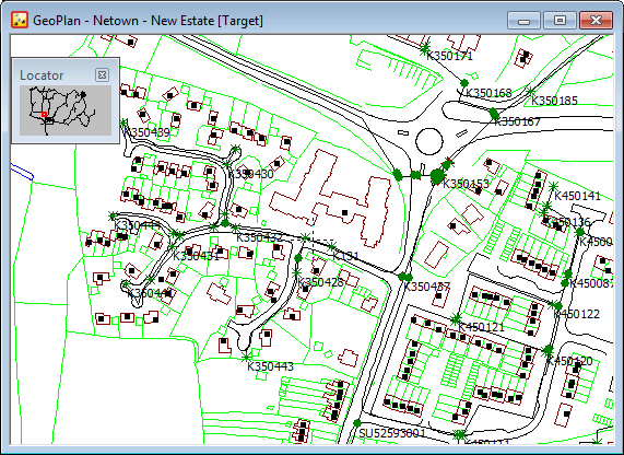

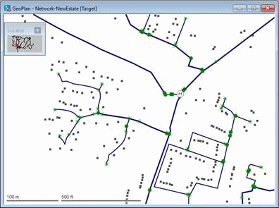

- Switch off the
display of the background map(s).
You can now see that the imported data forms a small network connected to the existing network.
- Select

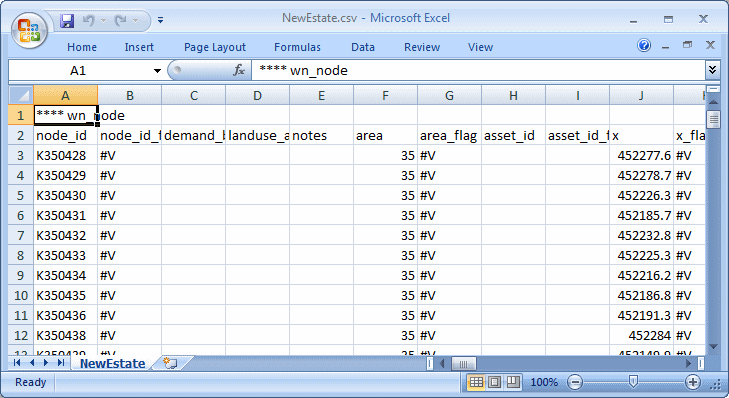

- Run Excel and open NewEstate.csv. From this you can easily apprehend the structure of the CSV file, and look at the imported data in more detail. Close Excel when you have finished inspecting the data.
The sample data also illustrates how easy it is to create a CSV file for import into
InfoWorks WS Pro.
