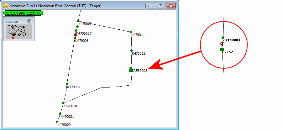

  1. If the simulation is not open in the current window, drag it onto the main window. Zoom in on the area around the reservoir CRES2.
    Zoomed in Network

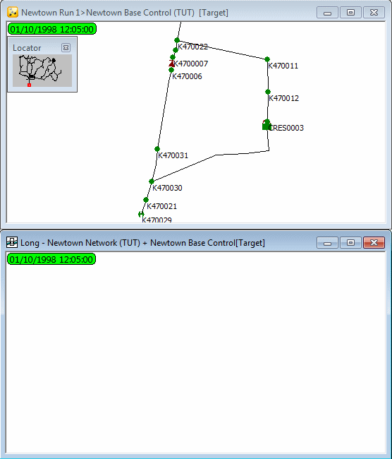

  2. Select the Long section pick(Long section pick) tool and click a blank area of the GeoPlan. An empty Long Section view is displayed. If required, use the Pan (Pan) tool and zoom options to adjust the display in the GeoPlan view.
    Empty Long Section view

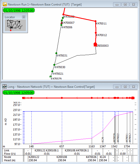

  3. At this stage, you can either select one or several objects using the available selection tools or drag a selection list, which has previously been saved, from the Selection List group onto the GeoPlan view. In our example, we are going to use the existing 'Pumps To CRES2' selection. Drag this selection onto the GeoPlan view.
  4. Right-click the Long Section view and select Create from selection. Alternatively, you could drag the selection list directly onto the blank Long Section view. This would create the long section and highlight the selection on the GeoPlan in a single operation.
    Long Section View
  5. The Long Section view is displayed for the selection. We are now going to set up some labels on the Long Section view. This is a valuable feature that can help you visualise the variations of some parameters of interest, as the simulation is run. For this, right-click the Long Section view and select Properties.
    • In the Long Labels section, click the Setup button.
    • In our example, we are going to select the following parameters in the Network Label Field Settings dialog (available only if there is a simulation):
      • 'head (Head)' for Node
      • 'flow (Flow)' for Pipe
    • Click OK on each of the dialogs.
      Adding Long Labels to the Long Section View display

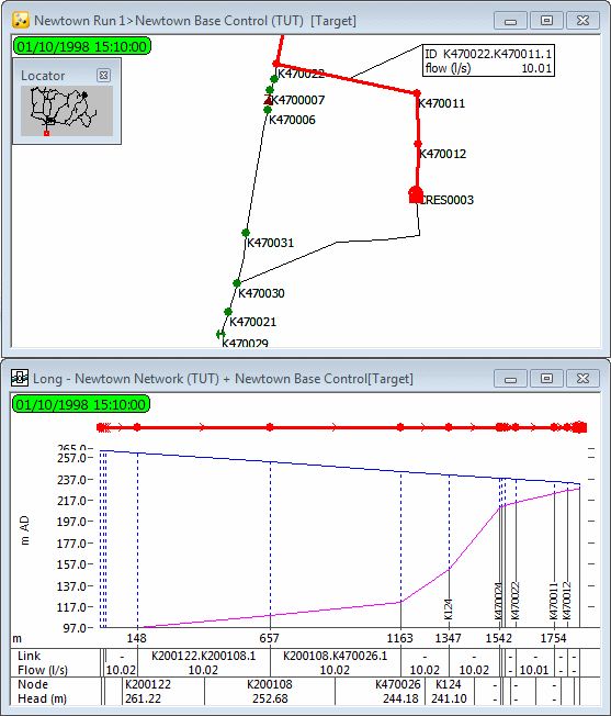

  7. Add a label to one of the pipes leading to the reservoir. Replay the simulation. The long section illustrates the change in flow when the pump is switched on and off. The actual values are shown on the GeoPlan labels and at the bottom of the Long Section view.
  8. You can run the simulation and pause it at a specific time to observe values at that particular time. In our example, use the replay buttons to take the simulation time to 15:10. The label shows that water is flowing back from the reservoir to the demands.
    Replaying the Simulation and looking at the results in the Long Section View
