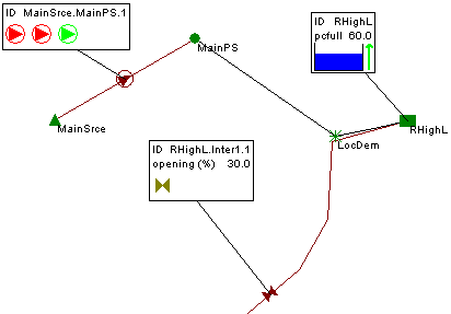

You can get visual feedback about some parameters on labels. If you select these parameters, a small graphic is displayed. The graphic is updated during replay of the simulation to give feedback on the state of the network object.
The parameters available are:
  • Reservoir - Percentage Full - A graphic displays the state of the reservoir with an arrow to show if it is currently filling or emptying.
  • Pumping Station - Pump State - An icon is displayed for each pump in the pumping station. Red means the pump is off, green means it is on.
  • Valve - Opening - The valve can be:
    • Green - fully open
    • Red - fully closed
    • Grey - partially open
