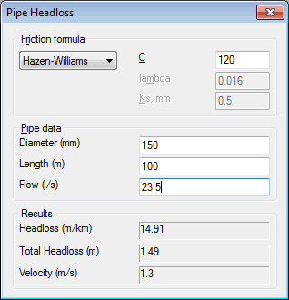

Pipe Headloss dialog
Use this dialog to perform simple calculations of headloss in pipes.
Choose the friction formula and enter the required data for roughness and the pipe parameters. When you start editing, the results are deleted. Each time you move out of a box you have edited, the results are re-calculated.
Display the dialog by choosing Pipe Headloss from the Tools menu.
Pipe Headloss Dialog
