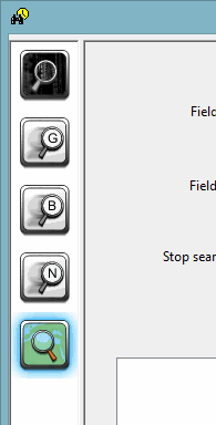

  1. Click the Find network objects button on the Operations toolbar.
    This will display the Find Network Objects dialog.
  2. Select GIS Find in the left panel.
  3. Select a GIS layer to search from the Layer dropdown list. All additional GIS layers currently loaded in the GeoPlan window that can be searched will be available from this list.
  4. Select a field to be searched from the Fieldname One dropdown list.
