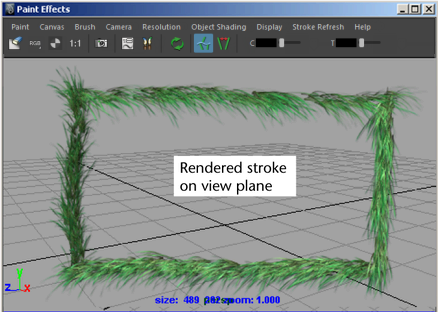

The view plane is the plane ortho-normal to the camera. You can think of painting on the view plane as painting on a sheet of glass that is facing the camera and fixed to it. When you change the view (for example, when you tumble), the view plane changes (the sheet of glass moves with the camera).

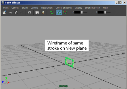

You can only paint on the view plane in the scene painting view—not the scene view. When you paint on the view plane in the scene painting view, each stroke renders on the view plane, as you would expect. However, the wireframe representation of each stroke displays between 0 and 1 in world space on the XY plane (near the origin). Although the wireframe representation of the strokes appear to overlap in this area, the rendered strokes display where you painted them.

  6. To paint, make a stroke across the plane.

    Note: Your stroke renders on the view plane, however, the wireframe representation of the stroke appears on the XY plane between 0 and 1 in world space. To see this press the Alt (Linux and Windows) or Option (Mac OS X) key on your keyboard.
