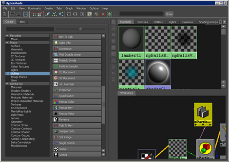

  1. Select Windows > Rendering Editors > Hypershade.
  2. In the Hypershade, under Maya, select Utilities then Particle Sampler.
  3. To make connections on the node, in the HypershadeWork Area do one of the following:
    • Middle-mouse-drag the node on top of the shading node.
    • Middle-mouse click the node and from the pop-up menu, select the listed connection, Default or Other.
      If you select Default or Other the Connection Editor appears to let you make the desired connections.
    Tip:
    If you are not sure which Particle Sampler Info node goes with which shader, put the shader in the workspace and use Graph | Up and Downstream Connections to display the associated utility nodes.
