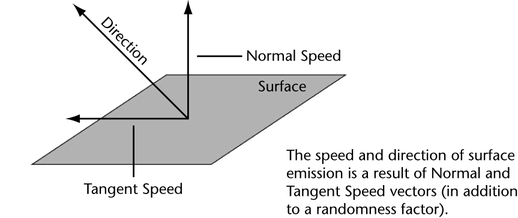

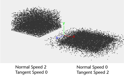

Tangent Speed
Sets the magnitude of the tangent component of emission speed for surface and curve emission (see the following figures). The default value is 0. You can enter a value of 0 or greater. Valid for surface and curve emitters only.
Normal Speed
Sets the magnitude of the normal component of emission speed for surface and curve emission (see the following figures). The default value is 1. You can enter a value of 0 or greater. Valid for surface and curve emitters only.

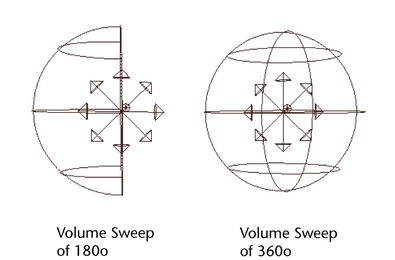

Volume Sweep
Defines the extent of rotation for all volumes except cubes. This can be a value between 0 and 360 degrees.

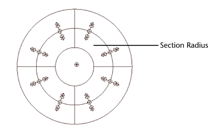

Section Radius
(Torus only) Defines the thickness of the solid portion of the torus, relative to the radius of the torus’s central ring. The radius of the central ring is determined by the emitter’s scale. If you scale the emitter, the Section Radius will maintain its proportion relative to the central ring.
