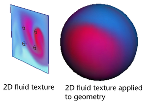

2D fluid textures
Mapping a 2D fluid texture to a surface shader creates the fluid pattern on the surface.

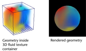

3D fluid textures
When you map a 3D fluid texture to a surface shader, the geometry that the surface is assigned to must be inside the fluid container for the texture to render. The texture renders only where Density contacts the surface geometry.
