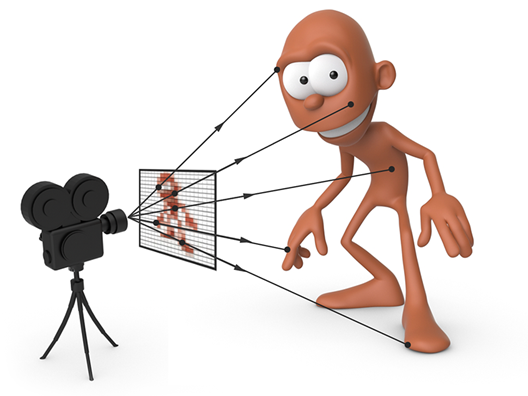

So, what is camera sampling? Basically, a number of rays are shot from the camera through each required pixel of the rendered screen window into the scene. These are called 'primary rays', but sometimes they are referred to as 'eye' or 'camera rays' (Camera (AA) (anti-aliasing)) as they are cast from the rendering view. Sometimes they are called 'pixel samples'.
The Camera (AA) value controls the pixel supersampling rate or the number of rays per pixel that will be traced from the camera. The higher the number of samples, the better the anti-aliasing quality, but the longer the render times.
Note that this process is not linear, as, for each of these sampling rates, the actual number of samples taken is the square of the input value. For example, if Camera (AA) samples is 3, it means that 3x3 = 9 samples will be used for anti-aliasing. If diffuse samples is 2, then 2x2 = 4 samples will be used for the Diffuse GI. The same applies to the other values.
These Camera (AA) samples could be described as primary rays (or pixel samples) and determine the overall quality of the image being rendered. Increasing the Camera (AA) samples improves the overall quality of the image, but it can often be wasteful because it increases the sampling rate for everything. W hen the source of noise is identified in the scene, it is more efficient to set the sampling values to increase the number of only those specific rays. If for example, there is a scene with lots of motion blur, a larger Camera (AA) sample is required, and therefore the other sample values can be reduced. Likewise, increasing Camera (AA) can also benefit indirect lighting, and therefore not as many diffuse samples would be required. However, if you were to reduce noise on the skin of a character, it would be more efficient to have higher SSS samples and not such a high value for Camera (AA) samples.

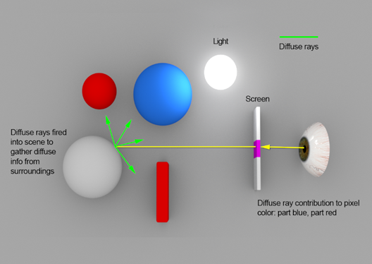

Indirect diffuse rays are rays that interact with objects and their surface shaders. Therefore, rays travel in the scene in directions determined by the shader assigned to the object. Transmission rays travel through objects. When a ray hits a reflective object, such as a mirror, only one reflection ray is traced from that point in a direction determined by the incoming ray. In contrast, diffuse rays are sampled randomly over the hemisphere around the hit point.
Diagram showing how diffuse rays are propagated in an Arnold render

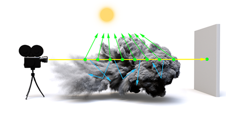

When sampling volumes, direct Camera (AA) rays sample the volume multiple times as they travel through it. Indirect rays (volume_indirect) behave similarly, sent multiple times as the ray 'steps' (volume step_size) through the volumetric object. Therefore, sampling a volume usually takes longer to calculate than sampling a surface.
Volume sampling. Direct lighting (green). Indirect lighting (blue).
At each step the ray travels, it evaluates the shader and accumulates the density of the volume. When these density values become more erratic throughout the volume, nearby rays can calculate substantially different values, introducing noise into the render. In this case, it may be necessary to render using more light volume samples or to reduce the step_size in the volume. Even with low sampling values, it can be expensive to render clean images with volumes.
