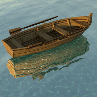

Fireflies caused by the sun from the physical_sky
This scene consists of a boat model on a plane that represents the sea. Both models have standard_surface shaders assigned to them. As you can see in the image above, there are many 'fireflies' in this scene. In this situation, they are caused by the bright sun disc from the physical_sky shader that is connected to a skydome_light. This kind of noise is difficult to remove by simply increasing the number of samples in the render settings. However, there are several ways to overcome this type of noise. We will work through some of these methods below.

We can instantly tell that they are coming from two places:
- The boat shader which has some specularity.
- The sea shader which also has some specularity.
When rendering out these AOVs, the fireflies are clearly visible:

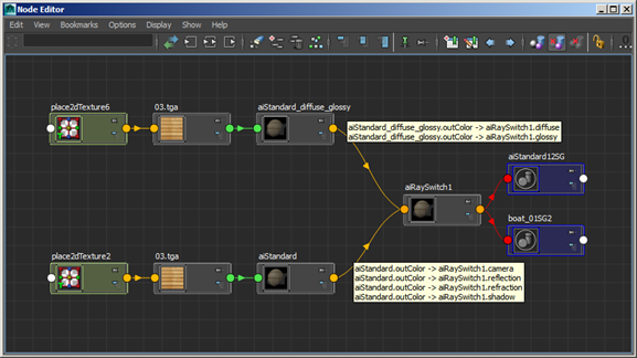

A better method is to assign a simpler shader for specular and diffuse rays using a ray_switch_shader.
- Assign a ray_switch shader to the boat.
- Connect a standard_surface shader to the diffuse_reflection and specular_reflection rays of the ray_switch_shader. Make sure that the specular_weight is set to 0. This will force specular and diffuse rays not to evaluate the specular component of the shader, which is the source of the fireflies.
- Connect the boat's standard_surface shader (with specular_weight) to the remaining attributes (camera, specular reflection, transmission, and shadow).
When we look at the AOVs we can see that the fireflies are not visible:
| indirect_specular AOV | rayswitch beauty (no fireflies) |
Two standard_surface shaders -> ray_switch_shader
