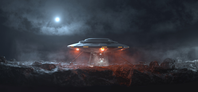

Volumes - UFO scene - Arnold for Maya
This 'making of' tutorial covers lighting and rendering volumes as well as some other issues when encountering certain kinds of noise in the render. This scene has the potential for 'fireflies' to appear as it includes small visible light sources, highly specular surfaces, and atmosphere_volume.

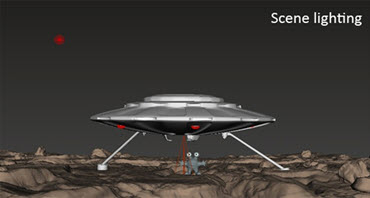

Scene Lighting

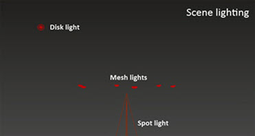

The scene is lit with an area_light with its light_shape set to disk (moonlight). The UFOs lights are geometry that have been converted to mesh lights. There is also a spot_light pointing underneath the UFO and an area light on the right side. Atmosphere_volume has been enabled in the MtoA Render Settings window.

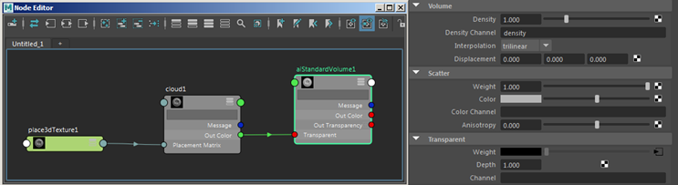

Cloud shader assigned to a sphere that represents the cloud layer
- A standard_volume shader is assigned to the sphere (increase the step_size of the sphere to 0.1 for it to render as a volume). A Maya 'Cloud' texture is connected to the transparent_color.

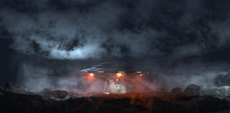

Once rendered, the clouds should look like the image below:

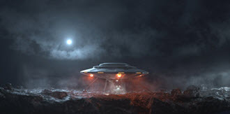

Disk light representing Moonlight with atmosphere_volume enabled.

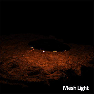

Mesh Light
The UFOs light's consist of geometry that has also been converted to a mesh_light. When a mesh_light is created, it is positioned in the same place as the geometry from which it was generated. This can be a problem when sampling light rays and shadow noise may appear. One way round this is to disable casts_shadows_ and receive_shadows for the geometry. Another solution is to move the light away from the object (see images below).
| The mesh_light is generated in the same position as the mesh | Moving the mesh_light away from the mesh can reduce noise |

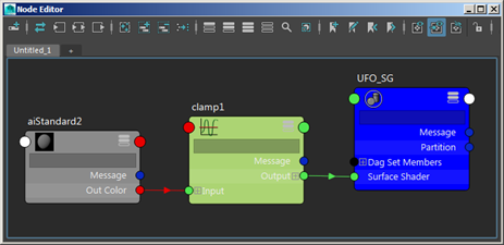

- Middle drag a Maya 'Clamp' node onto the 'Surface material' attribute of the Shading Group for the material that you want to clamp (in this case an Ai Standard shader).
Clamp -> Surface material attribute of the Shading Group of a standard_surface shader

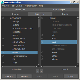

- Connect the 'outColor' of the standard_surface to the 'input' attribute of the clamp.
The shading network should look like this:

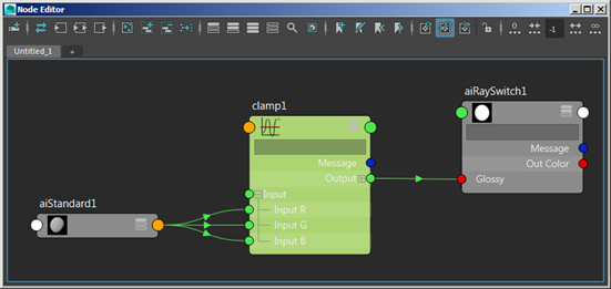

In the example below, the specular attribute of an Ai Standard has been connected to a Maya clamp node. The clamp node is then connected to the glossy attribute of the Ai Ray Switch shader. It will work as a secondary ray clamp instead of the general clamp in Render Settings window. This way you get the benefit of keeping your range in the direct highlights, but you can also control any secondary ray noise.
