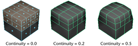

Continuity
The value you enter here determines the degree of smoothness.

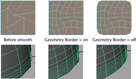

Geometry borders
When turned on (the default), this option preserves the properties of the border edges of the mesh. It controls the Keep Border attribute of the PolySmoothFace node.

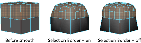

Selection borders
When turned on (default), this option preserves the properties of the edges bordering the selected and non-selected faces.
