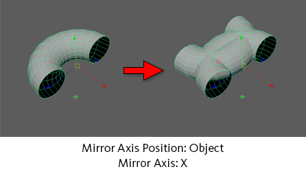

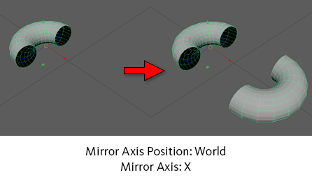

- Mirror Axis Position
Specifies the plane of symmetry on which to mirror the selected polygon object. Default is World.
- Bounding box
- Mirror relative to one side of an invisible cube encompassing the selected object.
- Object
- Mirror relative to the selected object's center.
- World
- Mirror relative to the world space origin.
