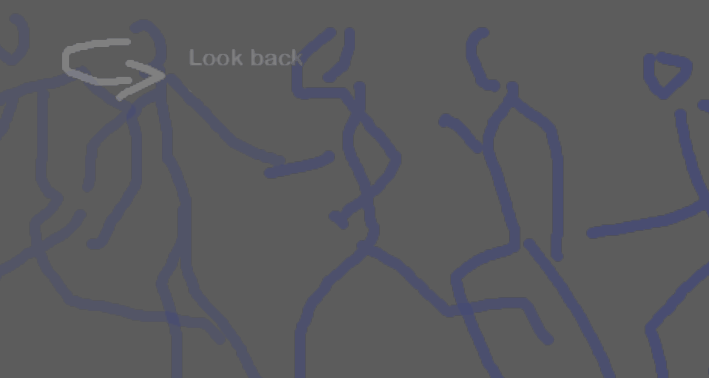

Use Blue Pencil ghosts to previsualize animation
You can show
Blue Pencil sketches on previous or upcoming frames, so you can preview what happened before and after the current frame.
Note: You can set
Blue Pencil ghosting preferences for your scene in the
Blue Pencil area of the
Display preferences.
For information on animation ghosting, see Ghosting Editor.

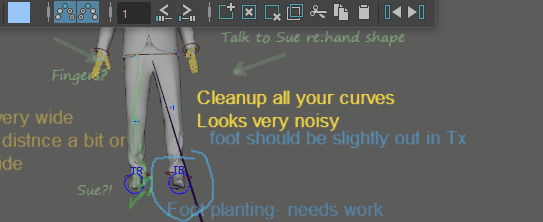

To see the Blue Pencil frames that appear before and after the current time
- Click the
Blue Pencil
Ghost Previous (
) and
Ghost Next (
) icons in the
Blue Pencil toolbar. The sketch opacity is affected by how close the frame is to the active frame. Sketches near to the current frame appear more opaque than sketches on frames that come many frames before or after.
