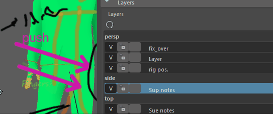

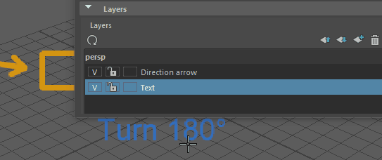

Add a layer to the Blue Pencil Layer Manager
- Draw in the scene. If no layer exists a layer is created for the current camera view.
- You can also click the
Add New Layer icon
Layers are grouped under the camera they are assigned. Layers are arranged in the Layer Manager the same way as they appear in the Viewport draw order. For example, a layer at the top of the Layer Manager displays as the top layer in the Viewport.

Rename a layer
Double-click the layer and enter a new name.
