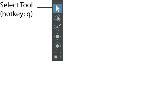

Tool Box. Double-click the Select Tool icon to display the Select Tool options.
Select Tool options

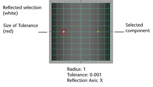

- Tolerance
Sets how closely the selected component and the component across the symmetry axis have to mirror each other in order to be considered symmetry. It only has an effect when Soft Selection is turned off.
When the value is set very low, a component must be almost exactly mirrored across the seam to be considered symmetry. Higher values allow the component’s position to vary slightly and still be considered symmetry. Increasing the Tolerance is useful when you want to select reflected components on a mesh that isn’t quite symmetrical.
The Tolerance value should only be a small fraction of the distance between components. For example, if each vertex is 0.1 units from the vertex next to it, then a Tolerance of 0.001 is appropriate.

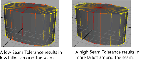

- Seam Tolerance
Sets the falloff around the symmetry seam when Preserve Seam is on. This controls how smooth transformations near the seam appear when components on the seam itself cannot be transformed away from the axis of symmetry.
Higher values increase the amount of falloff making your transformations near the seam smoother.
- Seam falloff
Controls the weighting of the falloff within the area defined by the seam tolerance. The graph represents the strength of the seam’s influence versus the distance from the seam.
The default shape of the curve specifies more influence close to the seam area and less influence at the outer edges of the Seam Tolerance. Areas with high seam influence are more resistant to moving away from the seam.
The shape of the curve can be manually adjusted by dragging existing points on it. You can add additional points by clicking the graph.
