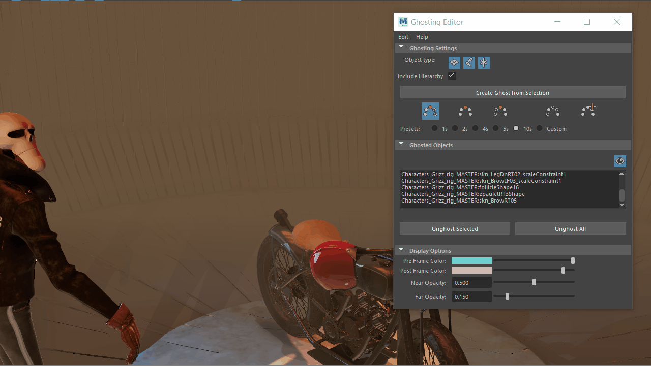

  2. Open the Ghosting Editor (Visualize > Ghosting Editor) in the Animation menu set (F4).
  3. In the Ghosting Editor, make sure that the type of object (Geometry, Joints or Locators) is chosen in the Object Type options (all options are on by default).
  4. Click Create Ghost from Selection and set the ghosting settings you want.

  1. Select the ghosted object(s) in the scene, either in the Viewport or the Outliner.
  2. Click Unghost Selected. You can also click Unghost All to remove ghosting from all objects in the scene.

    In the Ghosting Editor (Visualize > Ghosting Editor), specify how many frames you want between ghosts in the Frame Step section. You can choose between every frame (1s), every second frame (2s), every fourth (4s), fifth (5s) and tenth (10s) or use the Custom option to set your own.

  1. Select the ghosted object.
  2. In the Animation menu set (F4), select Visualize > Open Ghosting Editor
  3. In the Ghosting Editor, set the Ghosting Settings you want.
