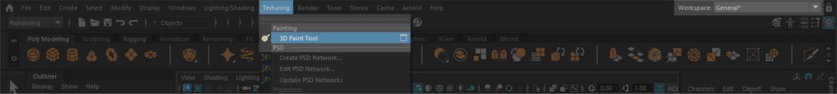

To paint on a 3D object
- Select the surface(s) you want to paint on.
Note:
- In the
Rendering menu set, select
to launch the tool and open the
Tool Settings editor. See
3D Paint Tool settings.
Tip: To ensure that you get expected results when you paint, it is recommended that you reset the tool settings before starting to paint. To do this, click Reset Tool. - Beside
