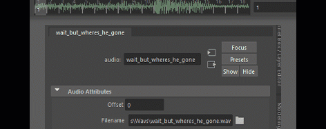

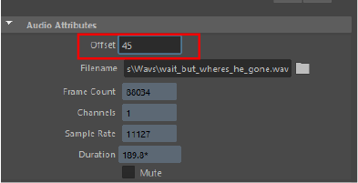

Create audio offsets
If you want audio files to start playing at a time different from the default of Frame 0 in your scene, click the option box next to the file. The Attribute Editor opens with the settings for the selected audio file.
Enter the frame that you want the audio to start in the Attribute Editor Offset field.
