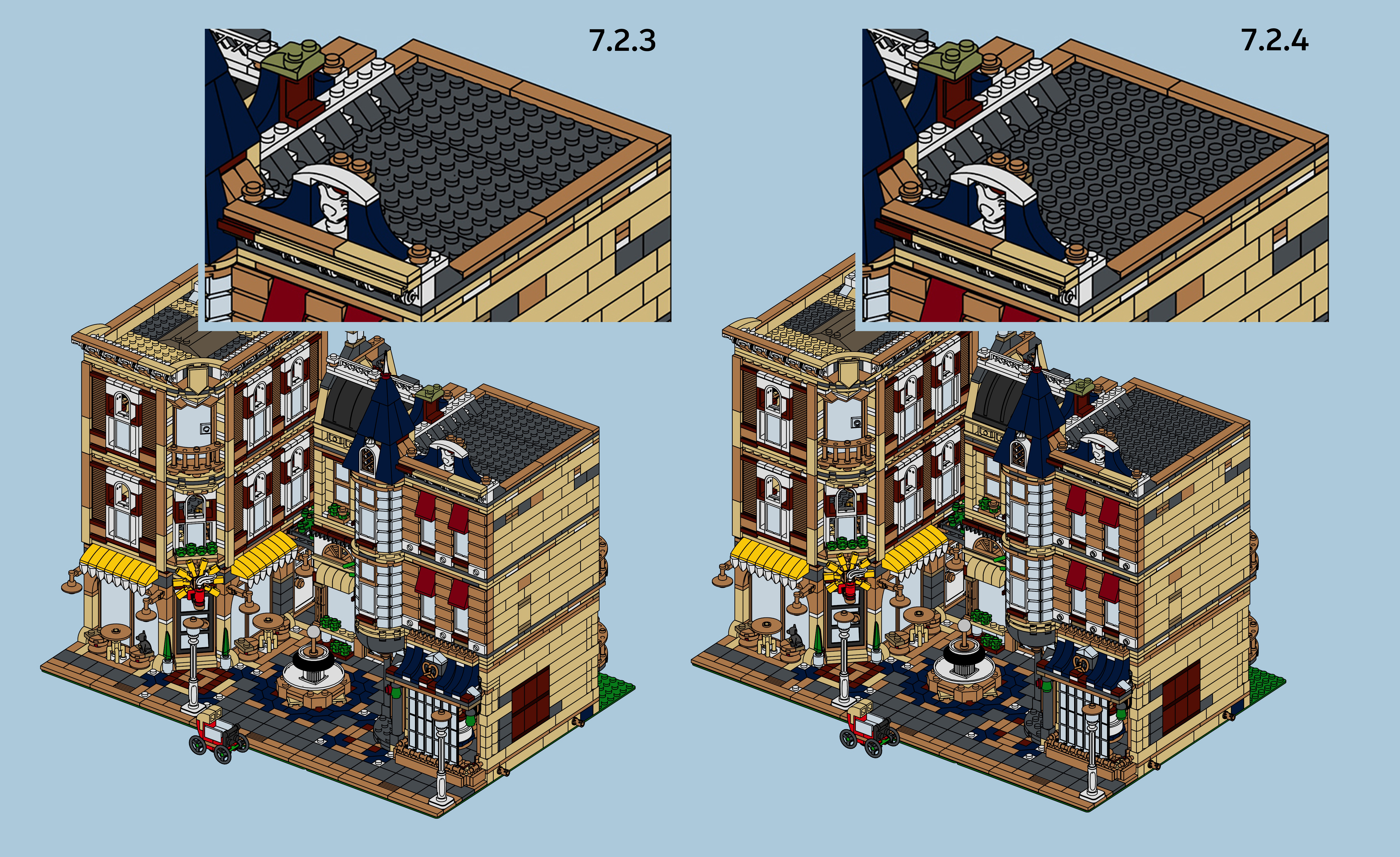

Toon shader - improved detection of internal edges: The toon shader now does a better job of detecting angle threshold silhouettes that are internal to a single object. This is most apparent in the regions between nearly parallel surfaces of an object that are at different distances to the camera. (ARNOLD-10560)

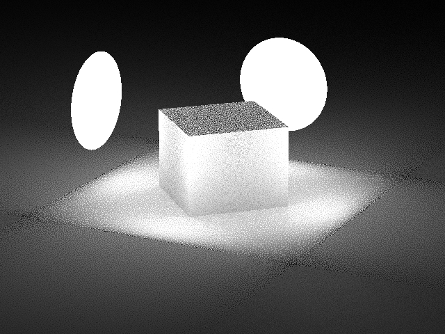

Improved Global Light Sampling behavior around flat lights: Reduced noise with Global Light Sampling for surfaces near or behind flat lights (disk or quad lights). (ARNOLD-13192)
