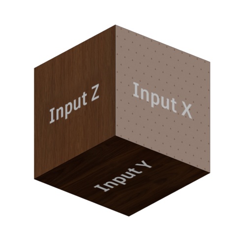

  • Per axis texture in triplanar: The triplanar shader can now optionally use different textures for each axis. ARNOLD-11708.
input_per_axis: disabled (default) input_per_axis: enabled

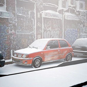

A wide range of shading effects such as snow, dust, sand, and moss, can be achieved using input_per_axis (Y).
Rollover images to view with and without triplanar.input_per_axis (Y)
A video that shows how to use the input_per_axis can be found here .

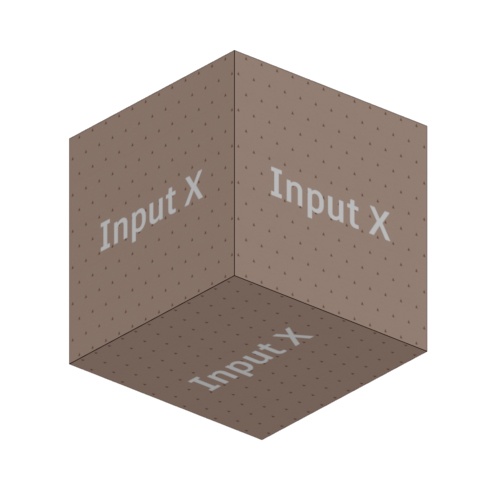

  • Flip_on_opposite_direction in triplanar: A new parameter called flip_on_opposite_direction can also be used to control the behavior of the shader on faces facing the corresponding negative axis. ARNOLD-11615.
flip_on_opposite_direction: enabled (default) flip_on_opposite_direction: disabled
