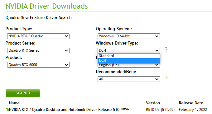

We recommend using the 511.09 (Quadro), 511.09 (GeForce) , or higher on Windows and 495.46 or higher drivers on Linux . See Arnold GPU for more information.
The driver type must be set to DCH.
I n the driver page select "Windows Driver Type:" DCH
The cache will also need to be re-populated after installing a new Arnold version, updating to a new NVIDIA driver , or changing the hardware configuration of GPUs on the system. More information can be found here .
