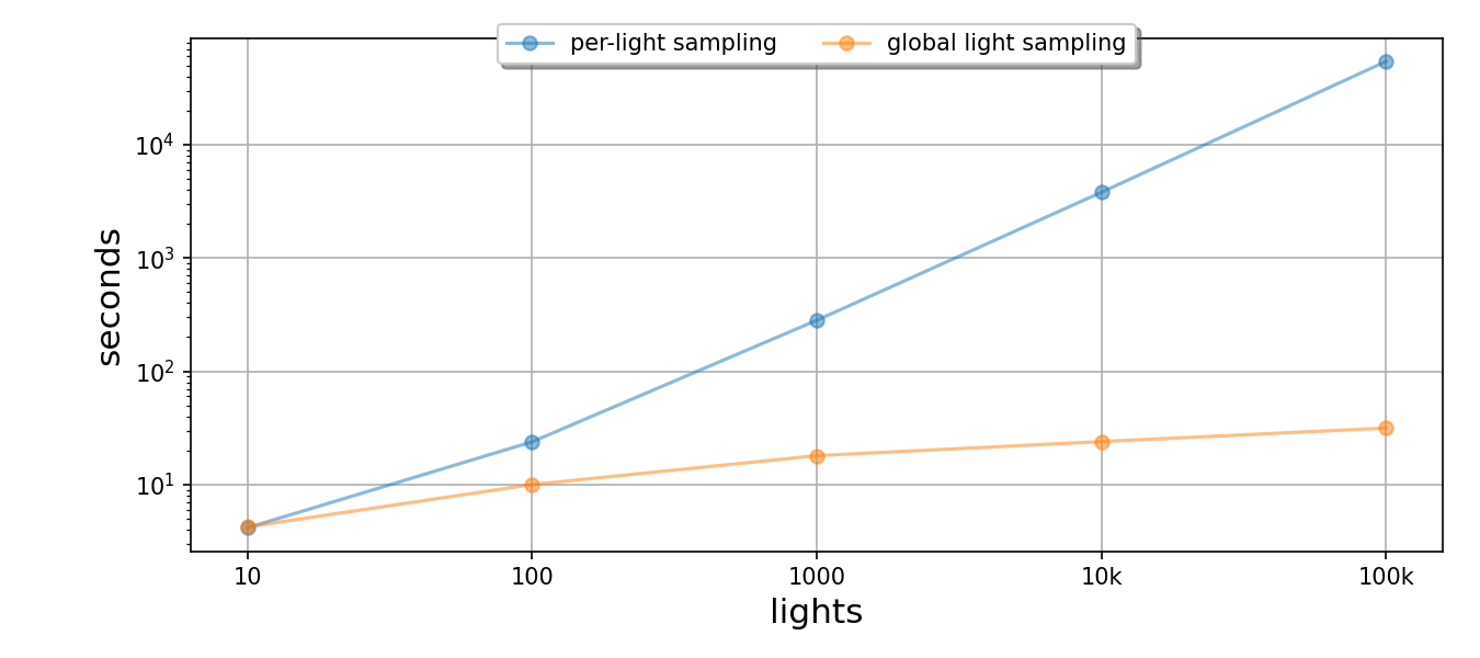

- Global light sampling: A new, more efficient sampling technique for lights is available. To enable global light sampling, set
options.light_samplesto a non-zero value. When enabled, the light sample settings on individual lights are ignored and the overall, global contribution of all lights together is computed usingoptions.light_samplesnumber of samples only. In this release, global light sampling does not apply to environment, directional lights, volumes, and GPU rendering. See the full documentation for more details. (ARNOLD-12860)
| without Global Light Sampling: 2 mins, 41 secs | with Global Light Sampling: 44 secs |
| For equal-quality renders of this scene, the new light sampling technique becomes progressively faster than per-light sampling as more lights are used. |
