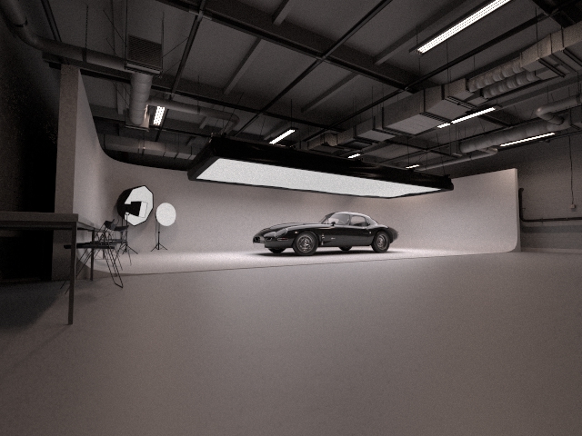

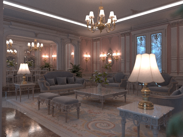

- Global light Sampling support on GPU: Global Light Sampling (GLS) is now available with GPU rendering. Many scenes with moderate to large number of lights render 2-6x faster with GLS. Scenes that do not benefit from GLS tend to be a few percent faster or slower. See the GLS documentation for important information on the optimal number of light samples to use with GPU. (ARNOLD-13109)
| Speedup over 7.2.2 GPU version using 1 light sample | ||
| City (100000 lights) | Classical interior (80 lights) | Automotive studio (9 lights) |
| 48x speedup | 2x speedup | 2.6x speedup |
