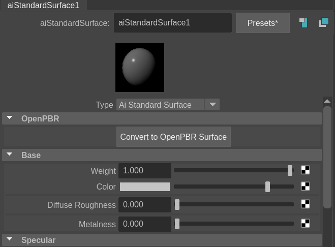

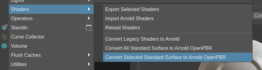

- OpenPBR Workflow Tools:
- Tools have been added to help convert aiStandardSurface to aiOpenPBRSurface (MTOA-1829)

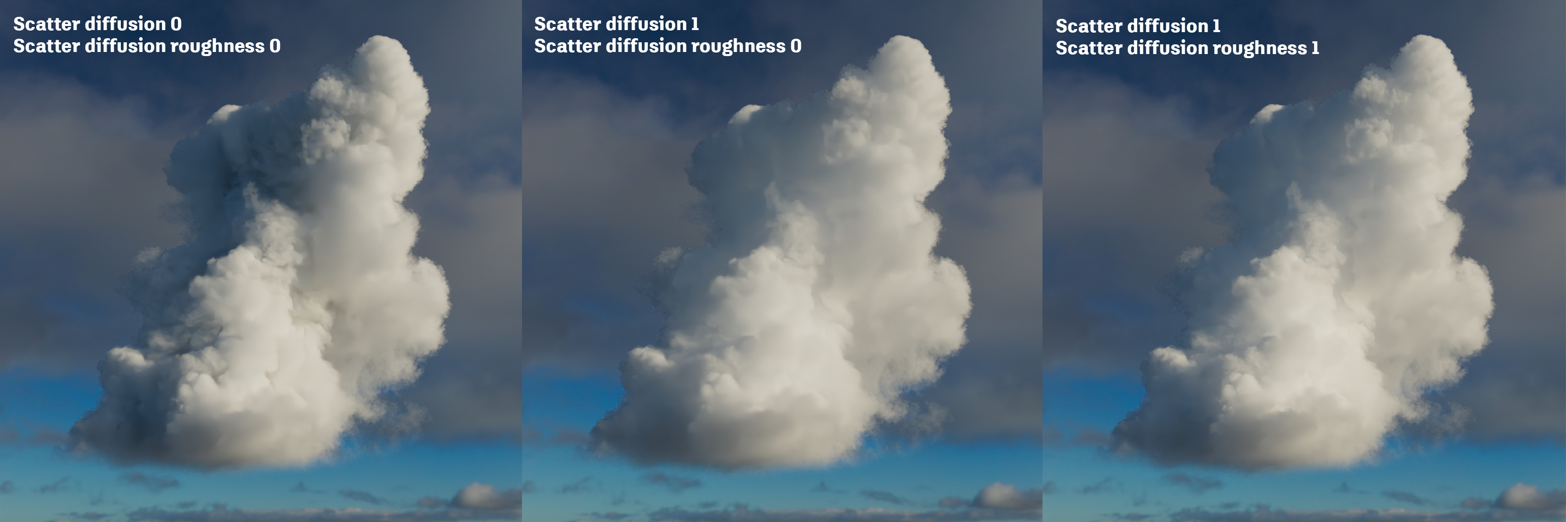

- Scattering diffusion in volumes: Two new parameters in
standard_volumeimprove how light is scattered in volumes. Using those parameters can help achieve high-scattering looks with fewer volume bounces and without adding energy. (ARNOLD-14482)scatter_diffusionaccelerates scattering in volumes.scatter_diffusion_roughnessaccelerates scattering further on anisotropic volumes and can help achieve realistic looking clouds with fewer bounces.gainandbiascurves can further tweak the effect of both parameters

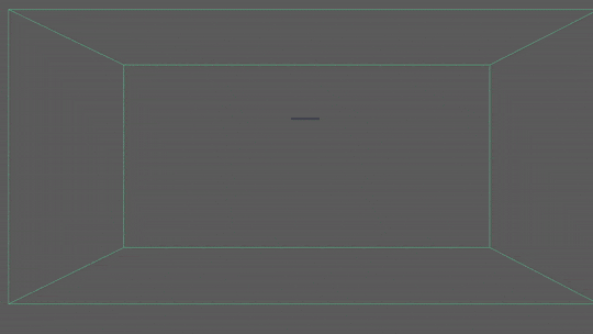

Sphere and Box volume added to aiVolume: A new attribute has been added to the aiVolume to set the volume shape to box or sphere, defaults to existing file mode (MTOA-247)

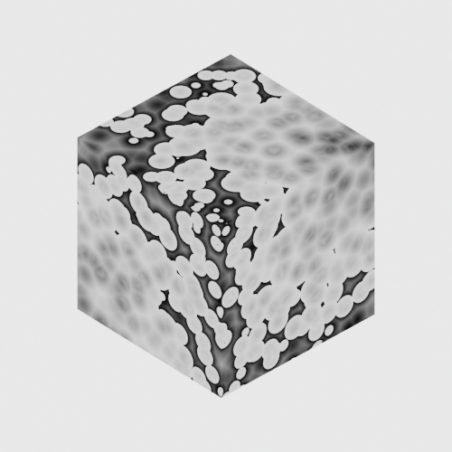

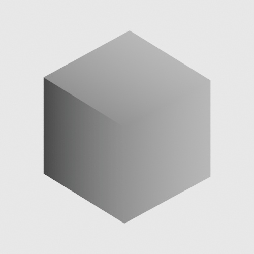

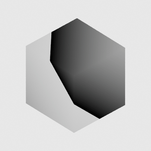

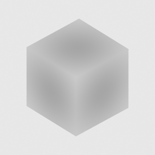

3D ramp modes: Ramp shaders have three new modes: 3d_linear, 3d_spherical, and 3d_cylindrical. These modes calculate the ramp input from the distance between the shading point and a user-defined reference point or line. (ARNOLD-15051, ARNOLD-15196)
| 3d_linear | 3d_spherical | 3d_cylindrical |

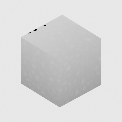

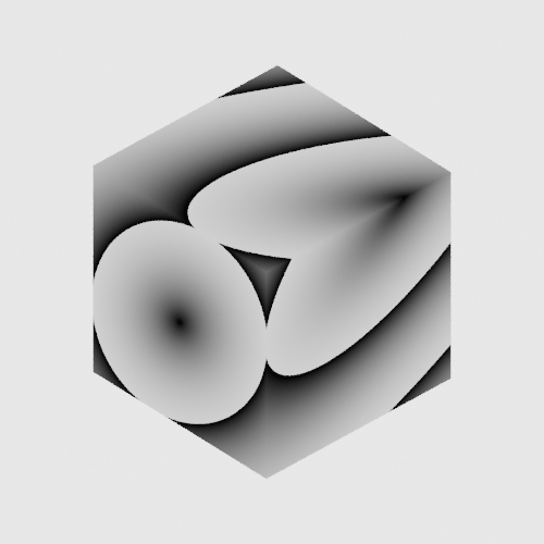

- Ramp offset: Ramp shaders can now offset the input value, which allows you to add noise to the ramp. (ARNOLD-15052, ARNOLD-15197)
| worley noise (3d_spherical) | cell_noise (u) | alligator noise (v) |

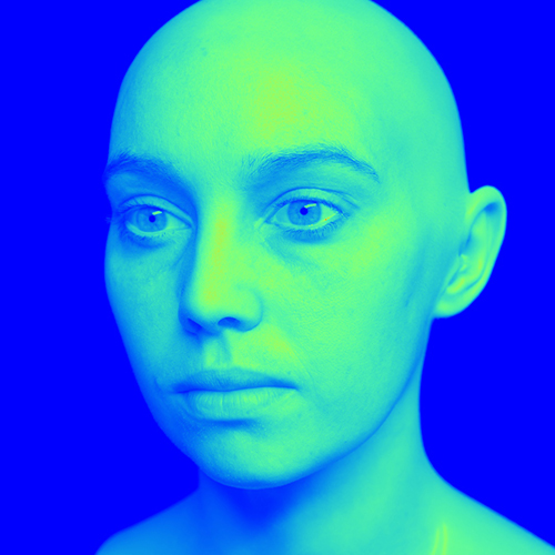

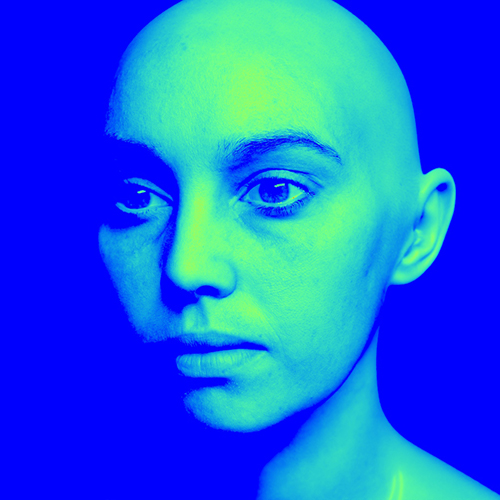

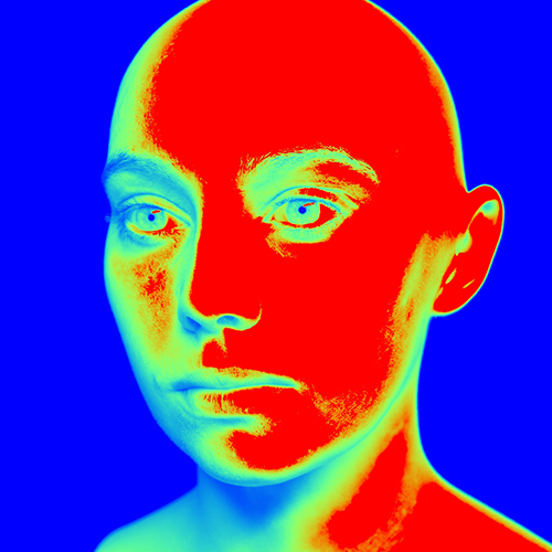

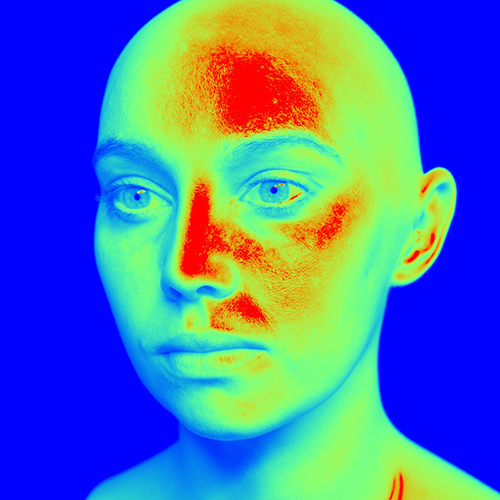

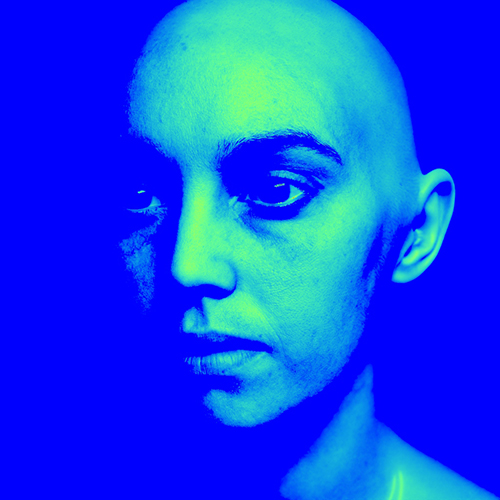

- Heatmap Imager Mode: The tonemap imager now has a heatmap mode that creates a spectrum based on a looked-up AOV quantity. The color ranges from blue (at minimum) to red (at maximum). (ARNOLD-15123)

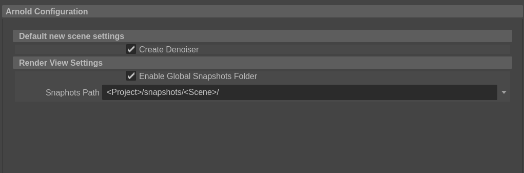

User preference for snapshots folder: There is a new user preference for the snapshots folder. You can override this by setting the environment variable ARNOLD_SNAPSHOTS_FOLDER (MTOA-1934)
