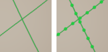

As you modify curves, it can be useful to view and manipulate the individual curve points. For example, if you have difficulty creating a hard kink using the Grab Curve
brush, displaying the curve points lets you see whether the curve has enough resolution to create the effect you want.
To display individual curve points
- Select Display > Curve Points from the main menu bar.
