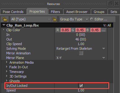

  1. Select a clip in the Story window.
  2. In the Properties tab of the Resources window, turn on In/Out Locked.

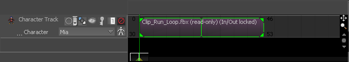

    The clip is locked and the following updates occur:
    • The title of the clip in the Story window updates to show it is locked:

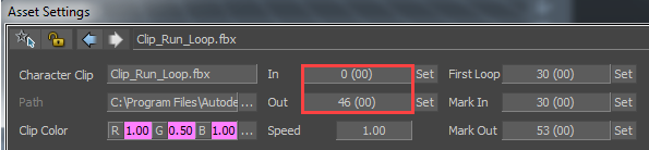

    • The In and Out parameters of the clip are locked and can not be modified:
