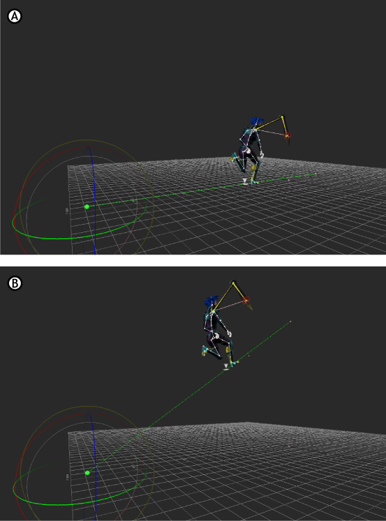

To change a clip’s trajectory in the Viewer window:
  1. Select a clip in the Story window.
  2. Translate and rotate it the Viewer window by manipulating its ghosts.
    Translating and rotating a clip’s ghost changes where the animation plays and in what direction. The ghost you select is the pivot point of the clip when you rotate it.
For example, in the next image, the start of the clip’s ghost clip vector is selected. The clip pivots around the selection. If part of the model ghost is selected instead, the clip rotates around that part.
Moving a clip in the Viewer window A. The start of a clip’s clip vector ghost is selected. B. The clip vector is rotated around the selection.

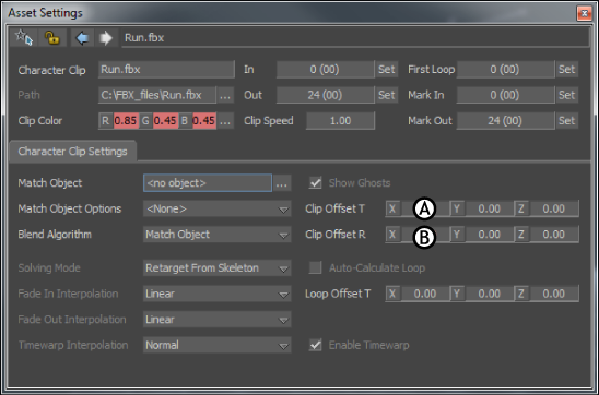

You can also translate and rotate a clip in the Viewer window by changing the values in the Clip Offset T and Clip Offset R fields (A and B) that display in the Asset Settings window and Properties window. These settings display in the Asset Settings window and Properties window when you double-click a clip.
Asset Settings window A. Clip Offset T settings B. Clip Offset R settings
