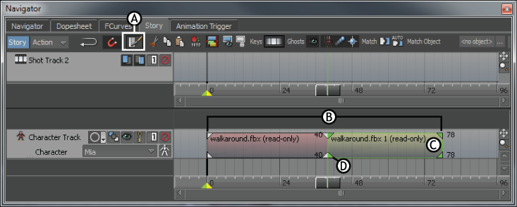

Razoring clips
Use the Razor button to permanently delete segments of a clip. If you want to change the starting and ending points of a clip without cutting any part of the clip, trim your clips instead. (See Trimming clips for more information.)
Razoring a clip can be useful when, for example, you want to add a right turn to a walk cycle. With the Razor button, you can cut a walk-cycle clip in half and then rotate one of the clip vectors in the Viewer window to create the turn.
To razor a clip:
  1. Select a clip.
  2. Place the Timeline indicator where you want to razor the clip.
  3. Click the Razor button.
    The clip is split into two separate clips at the Timeline indicator’s position.
    Story window A. Razor button B. Length of the original clip C. The new clip D. The clip was razored at the current time.
  4. Delete any parts of the clip you do not need by selecting and pressing Delete.
    Note:
    Deleting razored portions of clips is permanent. If you want to alter the clip so it starts or ends later, without cutting the clip see Trimming clips.
You can choose to slice more than one clip at a time. To razor multiple clips, place the Timeline indicator over the selected clips. Clips that are not selected are not sliced.
