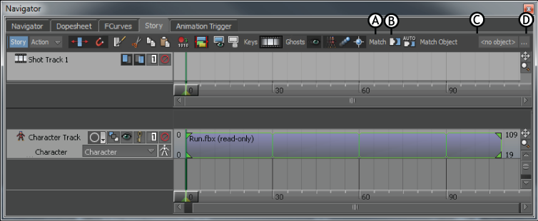

Match Controls in the Story window A. Match Options button B. Auto Match option C. Match Object field D. Match Object button

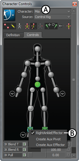

  3. In the Character Controls, select the character from the Character menu, and right-click a character effector to select it to be the Matching object, for example, the character’s right foot.
    Character Controls window A. Select your Character in the Character drop-down list B. Right-click an effector to select it

  4. Click the Match Options button in the Story controls.
    Story controls A. Match Options button
