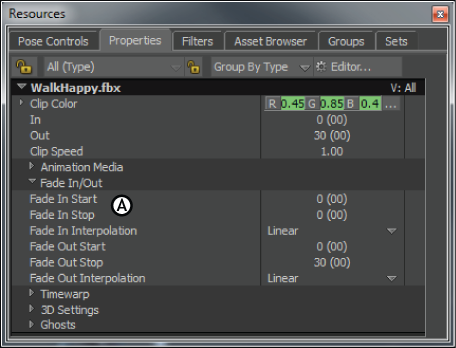

You can also change the values of a selected clip’s Fade In and Fade Out points in the Properties window.
Properties window A. Fade In-Out properties
