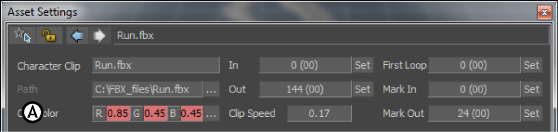

The Clip Color settings let you change the color of a selected clip. This can be useful if you need to quickly identify a group of clips.
To change the color of a clip:
  1. Double-click a clip on a track in the Story window. The Asset settings appear.
  2. Change the values in the R, G, and B, fields of the Clip Color field, or click the Color Window () button to open the Color window.
    Asset Settings window A. Clip Color settings
