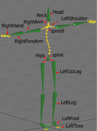

Create a skeleton in 3ds Max. Refer to the following example.
Tip: Use the Left or Right view to create your bone skeleton as it is easier to view the position of the bone objects as you create, move and rotate the objects.
3ds Max Hierarchy example
The green bones represent bones that must be dropped into the base slots of the Define pane in the Character Tool in MotionBuilder.

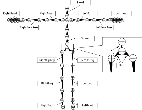

Build the skeleton using a standard hierarchy such as the one shown in the following diagram.
Skeleton hierarchy

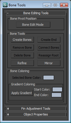

Select the bones you want to mirror.
For example, you may want to mirror the legs and arms.
From the 3ds Max menu bar, select Animation > Bone Tools.
Note: Bones are considered Geometry, which lets you use Scale and Squash channels. However, these channels are not supported in MotionBuilder.
In the Bone Editing Tools rollout, click the Mirror option.
Bone Mirror settings
Set the Mirror axis and Bone axis and click OK.
