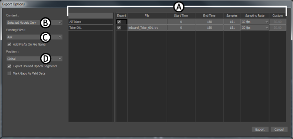

    If you select a motion file or skeleton file format, the Export Options dialog box displays when you click Save. This is where you specify the appropriate parameters for the motion file type you are exporting.
    Export Options dialog box with two takes A. Export Table B. Content area C. Existing Files area
    The Export Options dialog box is split into the following areas:
