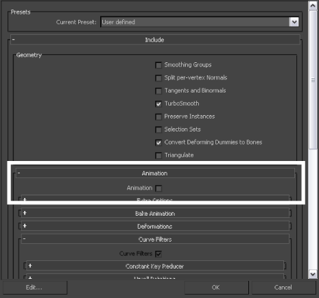

In the FBX Export dialog box > Include > Animation rollout, disable Animation.
Since you are only exporting a skeleton that has no animation, there is no need to export animation.
Animation option disabled in FBX Export

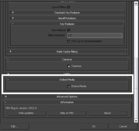

Expand the Embed Media rollout and make sure Embed Media is also disabled. If Embed Media is not disabled, disable it.
Embed Media option disabled in FBX Export
You only need to embed media if you export a mesh with the character. That way, any texture maps associated with the character are saved with the FBX file. In most cases, you would export a mesh, properly skinned on a skeleton. But in this case, you are only exporting a skeleton, so you do not need this option.

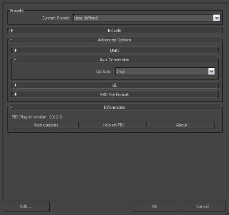

Expand Advanced Options > Axis Conversion, and make sure that the Up Axis displays the Y-up option as shown in the following figure.
Up Axis selected in Axis Conversion rollout
This setting assigns the exported character a Y-up axis, the orientation used by objects in MotionBuilder. The Y-up setting is required since objects created in 3ds Max use a Z-up orientation.

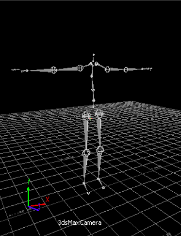

Launch MotionBuilder.
In the FBX Plug-in Import Options dialog, leave the default settings unchanged and click Open.
The 3ds Max bone system skeleton loads into MotionBuilder.

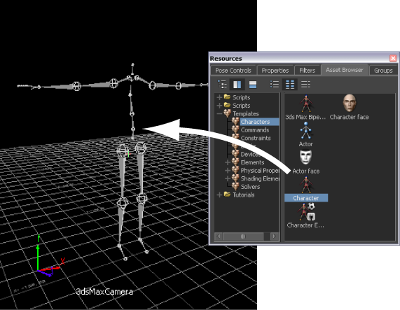

In the MotionBuilder Asset browser, expand Templates > Characters and drag a Character asset onto one of the skeleton bones.
The bone lights up when the asset makes contact with it.
Click Characterize in the menu that appears.

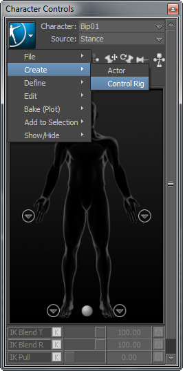

From the Character Controls menu button, select File > Create > Control Rig.
You must use the Control Rig Input setting if you intend to keyframe your character.

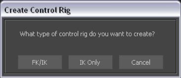

The Create Control Rig dialog box appears.
Click FK/IK.
FK/IK is the method commonly used to animate characters.

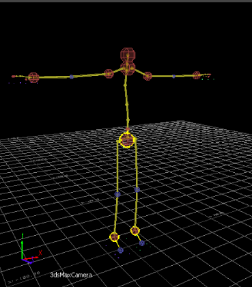

Make sure the Ctrl Rig option is selected in the Character Controls window > Source drop-down list, if it isn't already.
The Control Rig source activates the Control rig and the Character representation. The Character representation is an image of a human form meant to represent the biped skeleton. It contains all the effectors you need to animate the Control rig, as shown in the following figure.
Skeleton with IK/FK Control rig
Your character is now rigged and ready to receive animation.

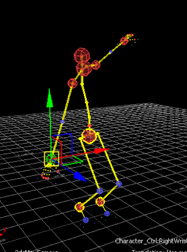

On the Character representation, select the Right Wrist effector.
Click the Full Body icon in the Character Controls toolbar. This lets you move the body using the entire Control rig.
Character Controls A. Right Wrist effector selected B. Full Body icon
Click in the Viewer window and press T.
The transformation handles appear.
Translate (or move) the hand down as shown in the following figure.
As you move the hand, the arm extends and the rest of the body follows in a natural movement. You can now transform the characterized skeleton.
