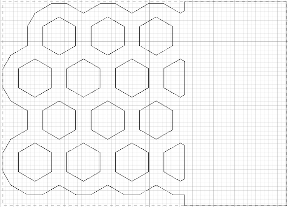

The thinwalls filter allows you to detect and compensate for thin walls which may be removed during a beam compensation (see offset filter). The thinwalls feature creates hatch lines which follow the skeleton of the polygon to allow you to paint a figure with a single laser beam.
