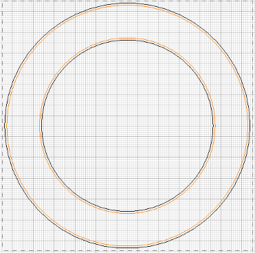

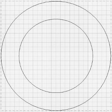

An offset filter is used to achieve beam compensation on the closed geometry of a slice. A single slice stack is given as the input. It is assumed that the input slice stack has no self-intersections. All resulting slices consist of closed contours, but the filter discards all hatches contained in the input.
| Parameter | Default Value | Description |
| value | Mandatory | Specifies the beam compensation radius. Positive values are offsets to the inside, negative values are offsets to the outside. |
