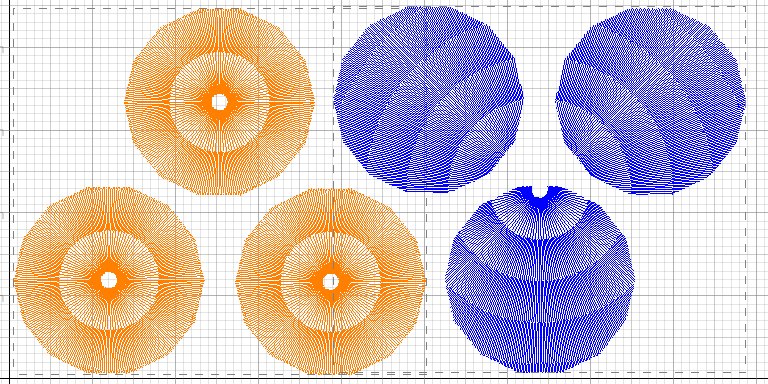

Radial hatching draws concentric rings composed of radial hatchlines. This is best used on annular contours like for vertical pipes. Rings are drawn in order of increasing radius.
Radial hatching as applied per island (left) or per slice (right)
