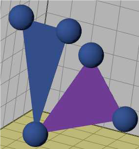

Tip: You can also right-click in the display and choose Add Faces. - Select three nodes to define the face.
- If necessary, click
Flip to switch the front and back sides of the face.
Tip: You can also right-click the face and choose Flip Face.
Faces always have an orientation, which means they have a front and a back side. If unselected, the front side is blue and the back side is purple.
