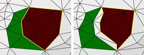

Left: Original mesh. Right: An offset of 1 mm is created.
Left: A selection of triangles before the offset. Right: The resulting offset.
