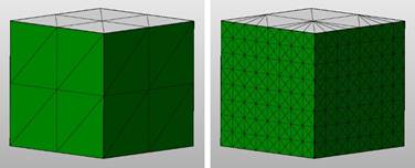

Note: You can select one or more triangles in the mesh and start the
Refine Triangle Mesh command to apply the operation to only the selected triangles, as opposed to the entire part.
A mesh refinement has been applied to the selected surfaces of this cube.
