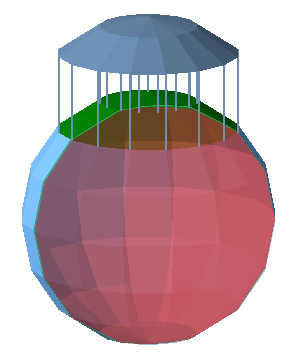

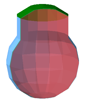

- Normal extrusion keeps the selected triangles and their sizes intact and shifts the nodes equally along parallel lines.
Normal extrusion works well with surfaces of any triangle composition.

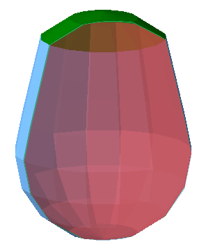

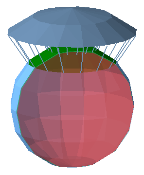

- 3D extrusion transposes surfaces along vertex normals (the average of the verticals on the triangles surrounding a common node), making extruded surfaces wholly thicker or thinner.
3D extrusion works best on finely meshed, organically shaped models. Hard, distinct edges, large or long and narrow triangles can produce undesirable distortion. To mitigate such effects, try limiting the extrusion to areas to exclude distinct edges, and refine the mesh or remesh entirely before extruding.

- Shift-drag to lock the extrusion distance and only adjust the direction.
- Ctrl-drag to lock the direction and only adjust the extrusion distance.
- Double-click any triangle on the part to align the extruded surface parallel to the clicked triangle.
- Double-click the triangle again to invert the extrusion by 180°.
- The same behavior occurs when you double-click on an edge of the part.
