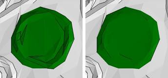

Left: Surface to be smoothed with several sharp angles between triangles. Right: Smoothed triangles without sharp edges.

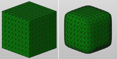

Smoothed Cube.
