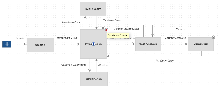

Out-of-the-box Fusion Manage allows us to configure an escalation on any state within a workflow. In the diagram below, an escalation is configured on the Investigation state of the workflow.
Escalations can be configured to run after a period an item in exists in a state. For example, in the screenshot below, we can see that after 3 days of being in a state a script will run that will send an email.

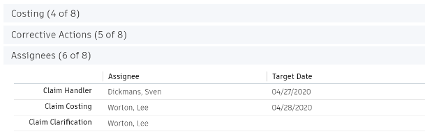

As an example, consider the following item that has two Target dates defined: one for the Claim Handler and the other for the Claim Costing. We would like to be able to remind the assignees of these steps perhaps 5 days before those target dates are reached.
