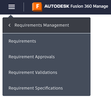

Make sure that your products meet market and customer expectations by defining all requirements in a connected environment, enabling to set goals for all your product creation activities. Derive and break down generic requirements into specific requirements which can be implemented and validated later. During the requirement specification process, assess and prioritize your requirements to focus on relevant and feasible requests.
Dedicated approval processes for requirements manage signoffs of requirements, provide revision control, and enable tracking of changes to the requirements specification.
menu
As product development starts, users can link the given design with related requirements to track their implementation by the product or project. Considering these relationships is key during change activities to make sure that requirements are still met while improving the product design.
Finally, test procedures can be defined for requirements to validate their proper implementation and achievement. Such tests can be performed repeatedly in case of failures and adjustments to the requirements.
This template makes uses of standard functionality like the My Outstanding Work list, automatic mail notifications, and reports. It includes all the workspaces described in this help.
