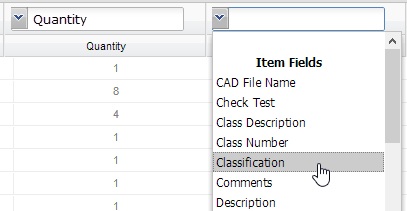

  1. Map the incoming Excel values to the corresponding workspace fields. From the drop-down list above each Excel column, select a workspace field.
    map field
    Note: Columns that are not mapped to a workspace field will not be imported.

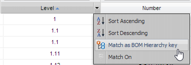

  2. Locate the column in the Excel sheet that represents the BOM hierarchy. Click the header for the hierarchy column and then select Match as BOM Hierarchy key to indicate that this column will be used to determine the BOM structure when it is imported.
    match hierarchy

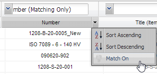

    Note: When a BOM is imported, the records in the Excel sheet are compared to the existing records in the selected workspace to determine which records are new.
  3. Specify which column to use for the comparison:
    1. Pick a column to use for comparison. If it is not yet mapped, map it to a workspace field.
    2. Click the Excel column header and then select Match On. The values in the column will be compared against existing records in the workspace.
      Note: Multiple numeric and text fields can be specified.
      match on

  1. Locate the column containing the classification system names. From the drop-down list above the column, select Class. This identifies the column as containing class system names.
  2. Locate a column containing classification properties. From the drop-down list above the column, select Field.
  3. The Choose Field dialog lists the system names for the classification fields in the workspace. Select the classification field to which the incoming property will be assigned and then click Select. Repeat this step for each classification property to be imported.

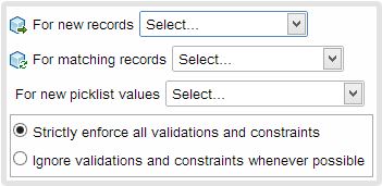

  3. In the For new records drop-down list, indicate how to handle new parent items:
    Add to the workspace
    Append new records to the workspace
    Skip
    Do not add new records to the workspace
    Error
    Do not add new records to the workspace and report an error
  4. In the For matching records drop-down list, indicate how to handle updates to existing parent items:
    Overwrite the existing records in the workspace
    Skip
    Do not overwrite the existing records in the workspace
    Error
    Do not overwrite the existing records and report an error
  5. In the For new picklist values drop-down list, indicate how to handle new picklist values:
    Add to the existing picklist
    Append new values to the picklist
    Use blank instead
    Ignore the new value
    Error
    Do not add new values and report an error

Enforce or ignore validations and constraints
Workspace fields can have validations and constraints associated with them to ensure that the proper data types are entered and that required values are supplied. You can choose whether or not to adhere to the existing requirements.
Strictly enforce all validations and constraints
All field validations and required values must be met
Ignore validations and constraints whenever possible
Field validations and required values that can be ignored will be ignored
