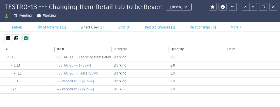

View Where an Item is Used
  1. Click the Where Used tab.
    where used
  2. To expand and collapse items in the list, click expand and collapse.
    Tip:
    Click Expand All expand all and Collapse All collapse all to expand and collapse all items in the list.
  3. To export the list to Microsoft Excel, click Export as Excel excel export.
