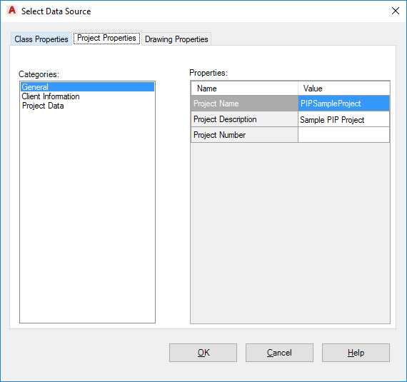

Project Properties Tab (Select Data Source Dialog Box)
Displays a list of project properties you can select as the data source.
Categories
The categories list on the Project Properties tab displays the default categories and any custom categories you have created.
  • General. Displays the default general properties and any properties you have added.
  • Project Data. Displays the default project data properties and any properties you have added.
  • Client Information. Displays the default client information properties and any properties you have added.
Properties
Displays the properties of a selected category.
By default, all project properties are included.
