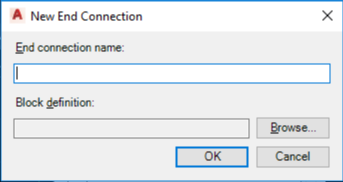

New End Connection Dialog Box
Adds a new end connection.
End Connection Name
Defines the name for the new end connection.
Block Definition
Displays the name of the block assigned to the end connection.
Browse
Defines the symbol that is displayed when the end connection is used. Displays the Select Block Drawing dialog box, where you select a drawing containing the block you want to use. Select a drawing and then select a block for the new end connection.
